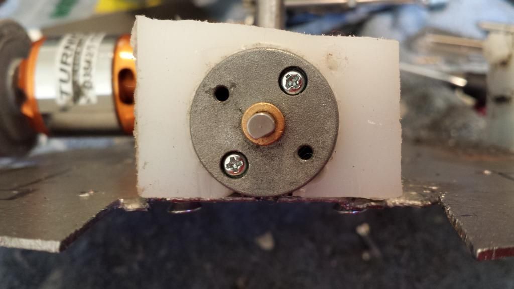

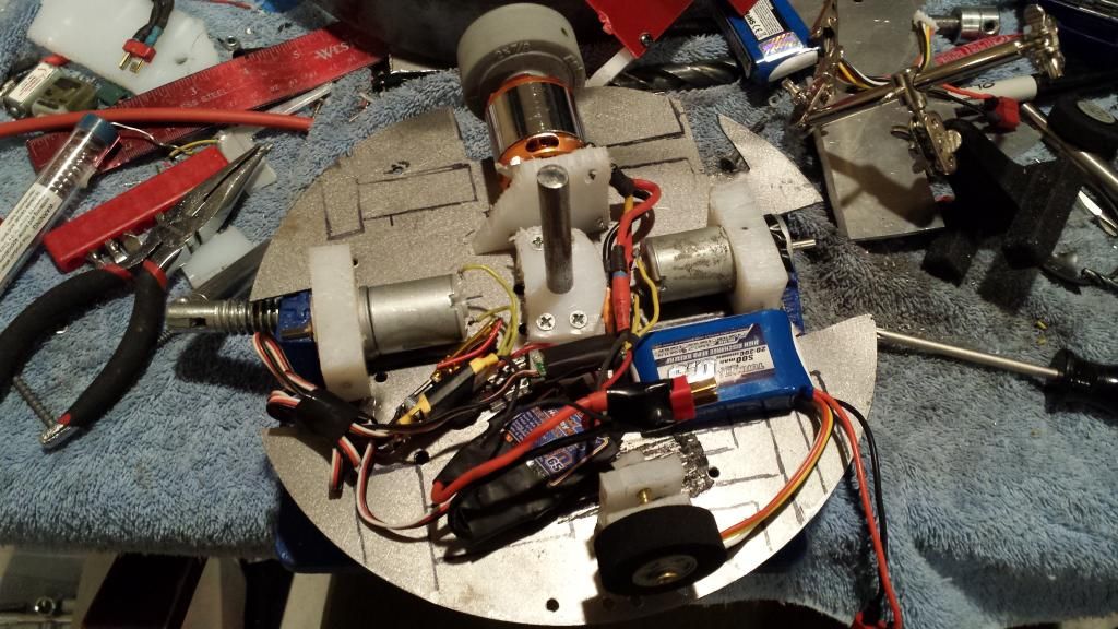

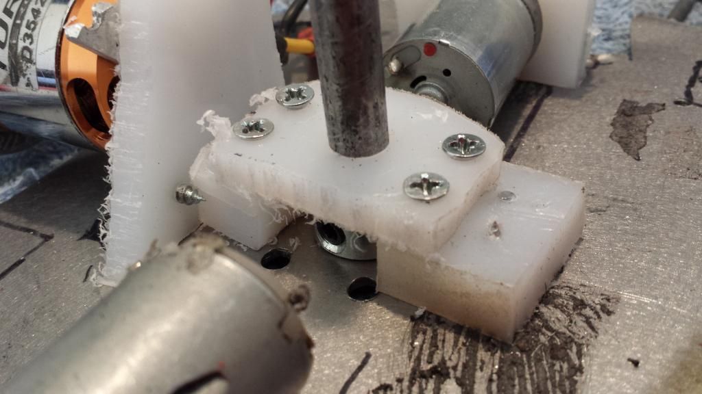

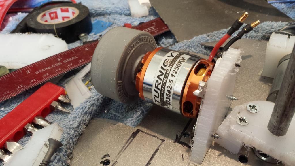

Some more progress on CATAPULT.
Tightened down the shaft. While it didn't become an issue at Bot Blast or in testing, it was always a place of concern that I knew I wanted to correct. Figured some 1/4" UHMW on top should be sufficient.
Attached the weapon motor. Another piece of 1/4" UHMW will definitely be able to hold it in place. However, I feel a support on the other side to provide more stability as well as not allow the system to flex much.
That mount basically clamps that motor to the baseplate in order to keep it as low as possible. I will need to make some solid metal faces for it though so it doesn't rotate inside the mount.
The chassis as  she lies.

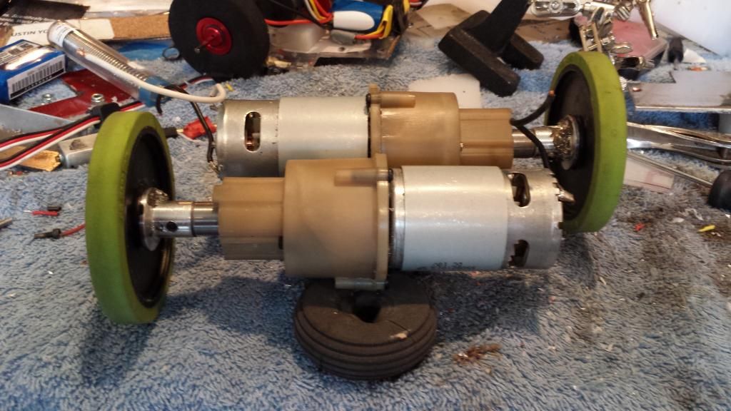

Thinking of positioning wheels like this to shorten that massive chassis. Any thoughts?
