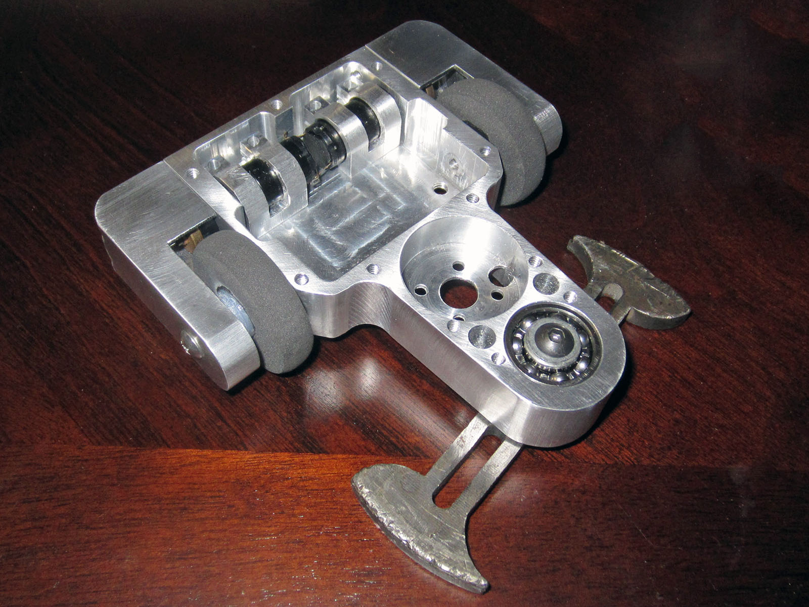

Not a lot of progress, more of a test fit of some components.  I cleaned up the old weapon assembly off of the previous Angry, and plopped it in to see how things fit.  I'll be making a new one, but this at least lets me see what things are going to look like.
I also made some hubs for the tires, and threw the motors in too.  The electronics are going to be a tight fit, but I should be able to get them all in main bay, including the 260mAh LiPo.

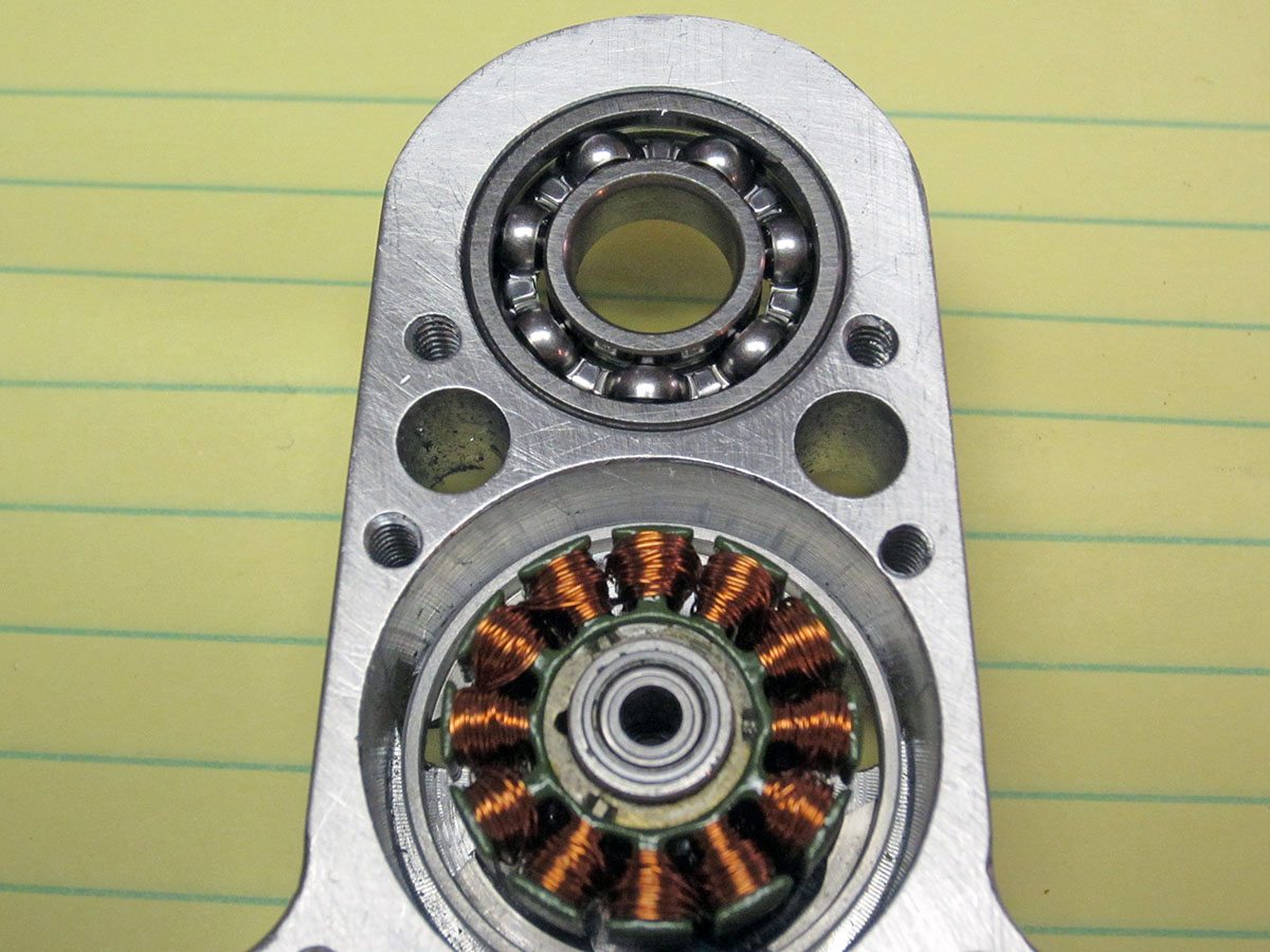

I've been playing around with getting pulleys and belts made.  I threw in a brushless motor and a giant speed controller.  I'm going for a fairly short motor so that invertibility should be manageable.
Here's a spinup test.  I draw over 5 amps for a bit, which is all my power supply will provide.  However, once the blade is up to speed, things settle down to about 2.5 amps with this GWS motor.

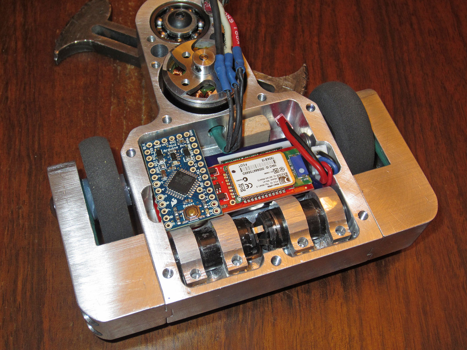

Electronics Test Fit
« Reply #39 on: August 07, 2015, 04:55:04 pm »
I'm starting to figure out how to cram all the electronics into the tiny bay.  I don't have all the components yet, so I'm dummying a few things up with blocks of wood.  If all the online sizes are correct, I should be able to squeeze everything in there, but there will be some crazy soldering going on.

Is the little block a fingertech switch? It's the size listed exactly. In fact, there's a CAD model showing it's exact dimensions. It can handle a silly amount of current, as well (more than a Deans connector :O).

You guys are good guessers.  That is the Fingertech switch, just ordered today when I realized I had room for it.
Underneath the micro-controller is another block that stands in for the Spider 12a brushless ESC.  I doubt the measurements on HobbyKing, their numbers seem to be off on a lot of things.  If it's bigger than stated, I can put a hump on the top plate to accommodate.

So you're going to control it using bluetooth and the microcontroller even though you're not doing sensors and stuff? Seems like it'll take up more space that way. HK specs are usually pretty accurate for motor dimensions and stuff but I don't really trust electronics and batteries too much; I've had them be off in both directions, smaller and larger.

There's a few things working against using normal RC equipment:
  • My existing receiver/transmitter is old FM style stuff, which is much larger
  • I already have the bluetooth stuff
  • My drive motor controller has to be MCU driven
  • I bet the components I have are smaller than the corresponding 2.4ghz components
  • This is a good opportunity to learn a bit on the MCU side, and get a framework written for the next semi-autonomous project
Pete - Team Cosmos
