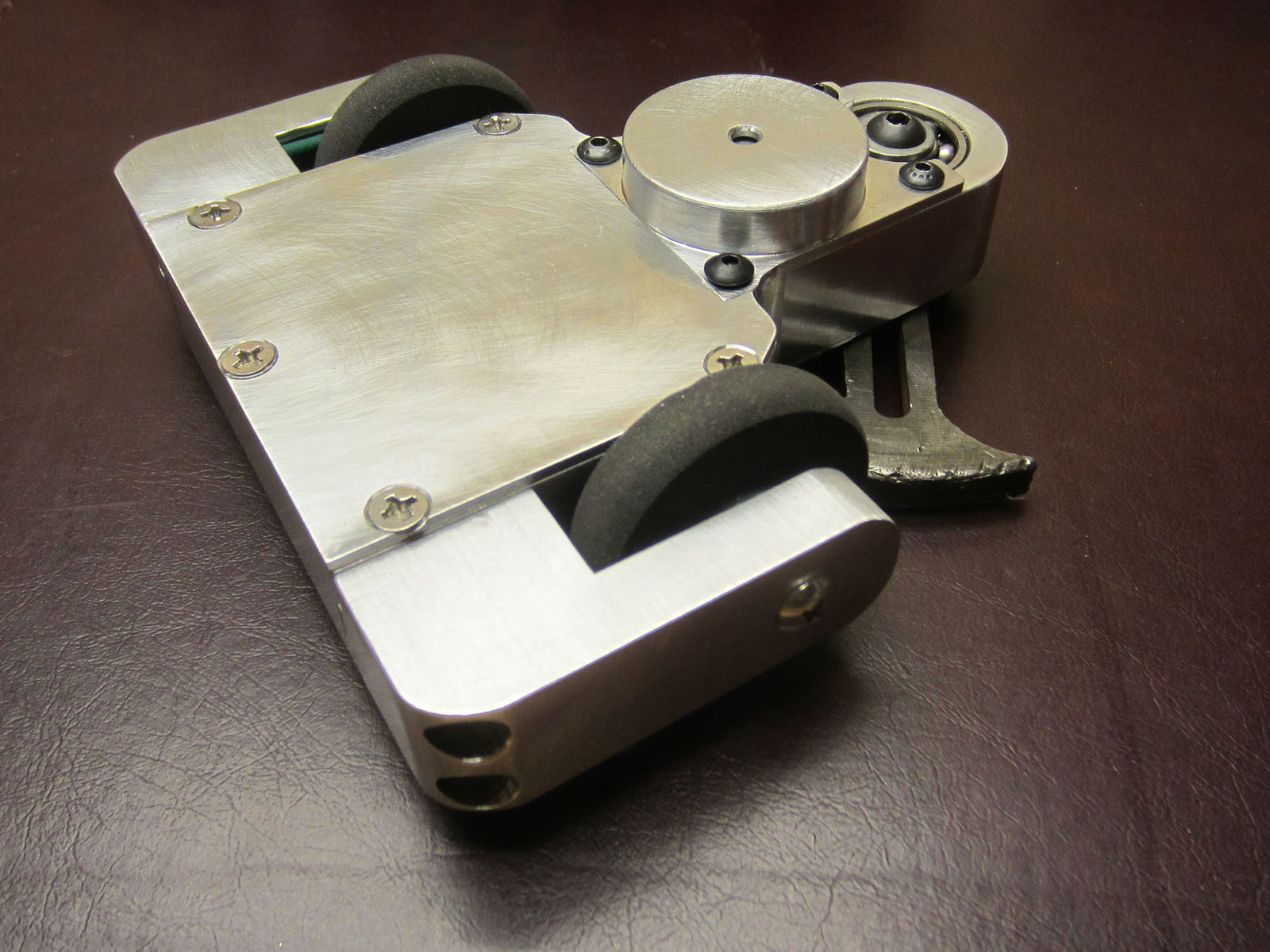

It looks solid! Can't wait to see it with a new weapon! What size motors are you using for the weapon?

Damn that's pretty.

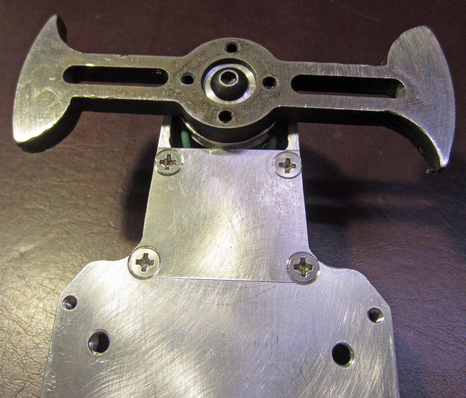

The motors I'm playing around with all are 28mm in diameter, just varying the height of the can.  I'm shooting for about 2000 rpm per volt, with a 2:1 reduction, so I should end up around 7k rpm.  It feels about right when spinning up.  It won't be at the crazy end of the rpm scale, but enough to do some damage.  The goal with Angry has always been to come back for more until the other guy breaks, not necessarily a one hit kill.

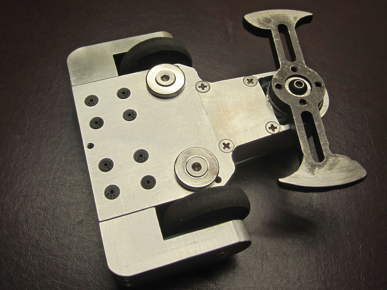

I managed to squeeze a belt cover under the blade.  Let's see those pesky drums knock my belt off now!

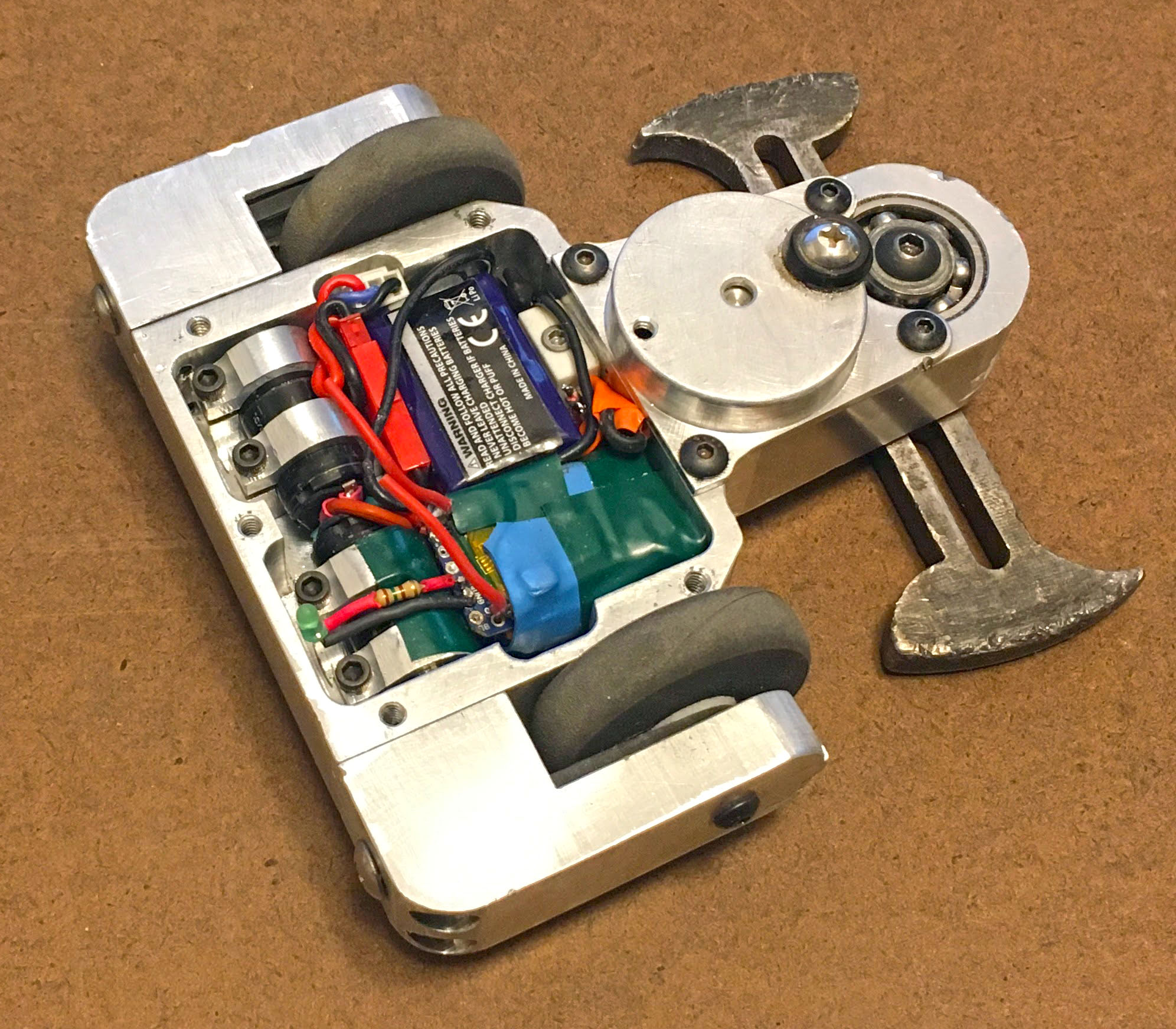

Progress has slowed down a bit, but I'm making a bit here and there.
Here are the electronics wired up and working.  Things barely fit in the body, it's a tight fit.  Note the classic electrical tape, hopefully preventing shorts of any sort.
I can drive angry around via a telnet session, but that's pretty rough.  Next step is to write a test program so I can have more intuitive controls.  I'll post some video once I have that working.

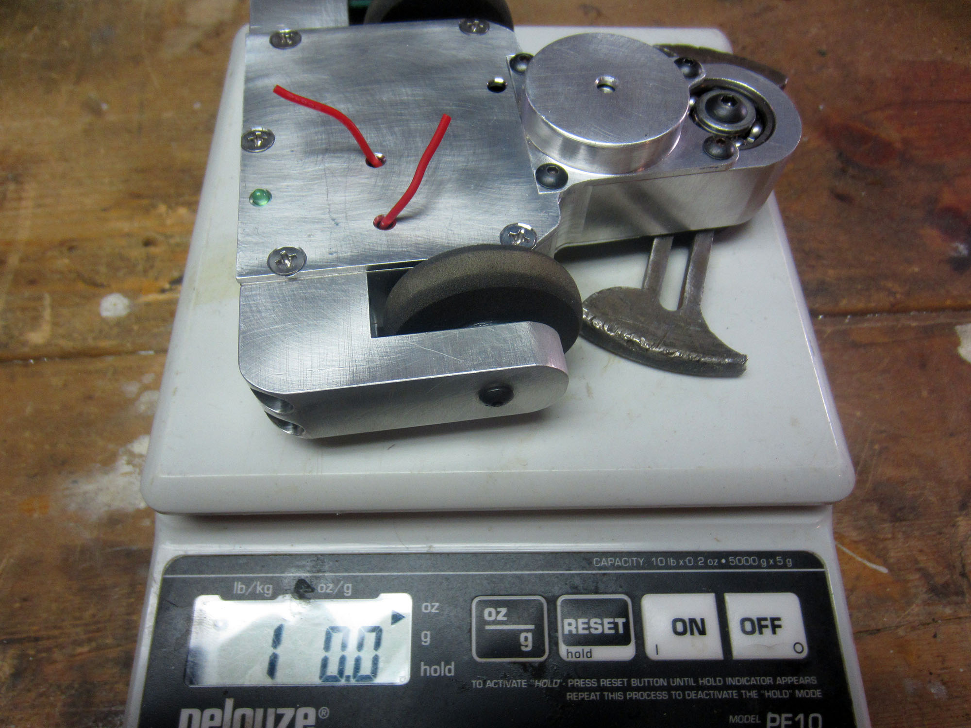

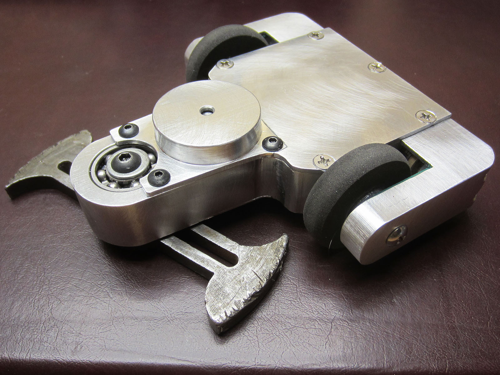

I added a motor guard with a bit of the weight I had left over.  Things are pretty protected at this point, have to admit that I'm happy with the design.  I have almost an ounce left for weight, I'm still toying what to do with that.  I still need a new weapon blade, weapon shaft, and a few holes in the top plate for power access and radio use.

Might be worth putting some sort of cover over the bearing to keep arena crud out of it.

I love seeing nice and tidy electronics layouts :)
